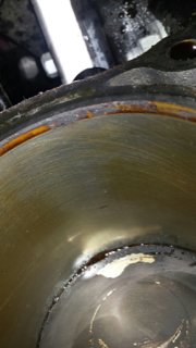

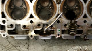

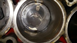

Here are some pics of the damage. I'm still waiting for the engine to come in.

Yeah, that is nasty.
whetrick1
May 21, 2016
1,311
301
Yep looks real bad

thanks for the giving us the final outcome. Too often we don't hear the resolution. But I am curious, I wasn't able to tell from the pics, where the failure occurred. Was it a keeper failure? Did the valve head seperate from the stem? What was the initial failure which was the cause to the engine seizure?
