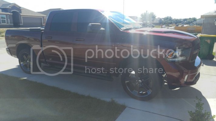

I'm running the Maxtrac 2.5" coils and shock on my '17 sport. Definitely spend the extra money and get this kit. You'll retain a factory ride as opposed to the spacers that may make it a bit rough.

Did you go with the maxtrac shocks or bilsteins with your coil kit? Any problems with the alignment? Do u have any more pics.

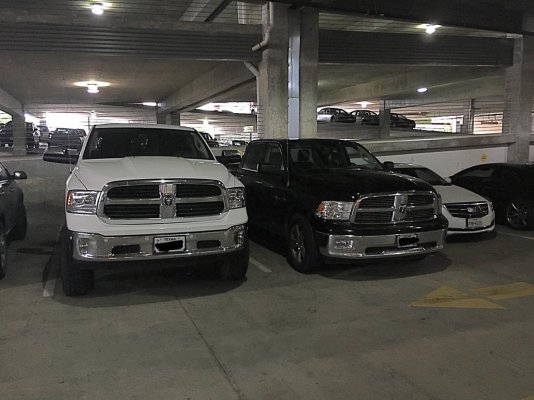

the Bils adjustable shocks are only for 4wd trucks, not 2wd.
The bils in their kit are not adjustable. They're made for 2WD trucks. I went with the 7" kit with bils on mine and am very happy with the ride. Here's a comparison to stock:
I don't have any other pics at the moment. But it sits dead level. I just used Maxtrac shocks which are still better than the stock shocks.
You quoted me so I'm assuming you were referring to what I said. I said the adjustable bils (the ones that can lift/level the truck) are only for 4wd trucks. They have regular shocks that are for 2wd.
