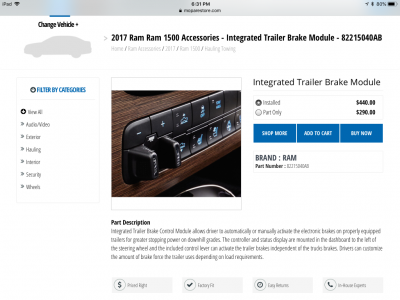

Yes, I just checked online and it’s less than $500 to have one added at a dealer. Just got a recall notice on the cruise control, so I’ll bring it in for that and have one added. I guess it’s kind of a no brainer to add one. Apparently someone lived in the the trailer for many years not moving it, so maybe breaks will work. I’ll find out pretty quickly once the tbc is installed.
This is from the mopar store online. $440 installed. That’s all I really know.
