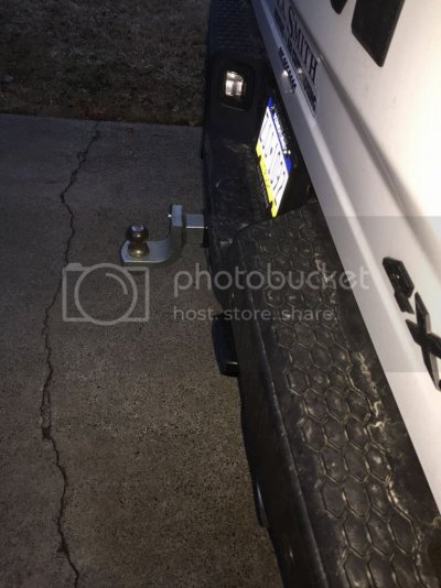

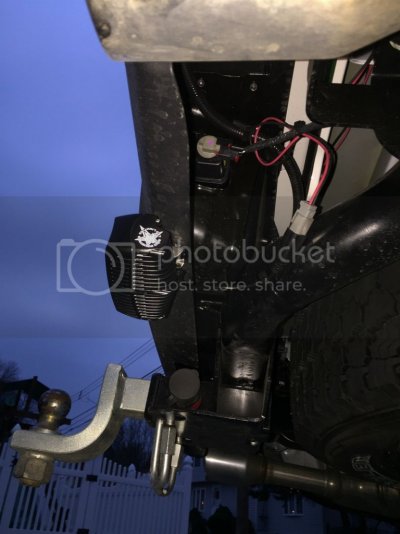

I got the lights mounted last weekend. I had to drill two holes and was hoping they would sit a little further back from what they do but it's not bad. I sprayed some paint on the fresh holes and then put a little bit of caulk on the washer and bracket to try to keep the water out so it doesn't rust up. It's much easier seeing at night backing up now. I wired them into the purple wire of the back up light bulb so they come on automatically when I back up.
I didn't realize the door came in that far but it just makes it.

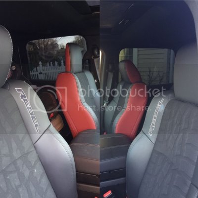

A little update. I miss my F150 seats cause looking cool doesn't mean they're comfy. I had to take the head rest off and put the rear one on cause they put your head at a horrible angle. I'm not sure if it's the way the seat broke in or how they made it but the passenger side doesn't feel as bad so I'll have to ask the stealership when I go for the 1st oil change about it. So far the rest of the truck has been good. I have 4,600 miles on it already, I think this would be the last Ram I'd own just cause of the seats and the way they did the interior since they don't have the room the F150s give you. I'm waiting for it to get warm and stay warm to do the HID conversion since I don't want to mess with the plastic trim while it.s still cold out.

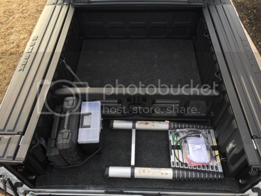

I got a Bedrug mat for the back and I was expecting it to be a little different but it's still nice to have.

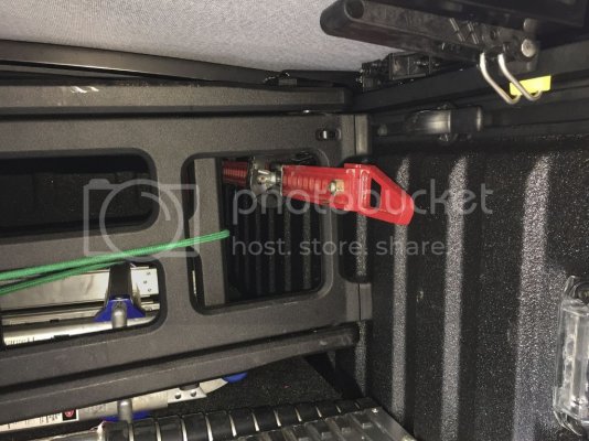

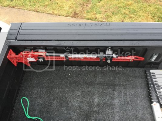

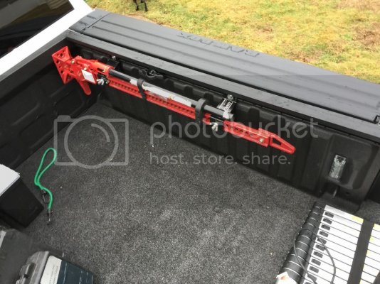

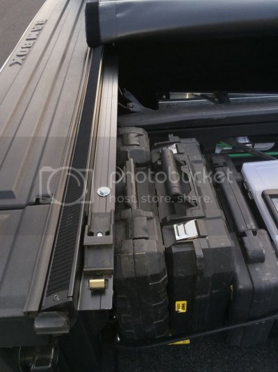

I got the Hi-lift jack mounted on the rambox bar with using the Hi-lift jack mounts and a unistrut channel nut.

Cool. It took a little bit for me to realize I could do it this way since I was trying to figure out how to mount the jack in the bed.
The weight of the jack broke the inside of my bed so I had to take it out. Did those tie down rails come from the factory?

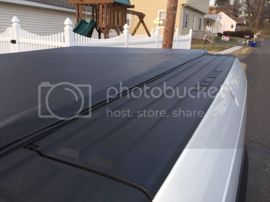

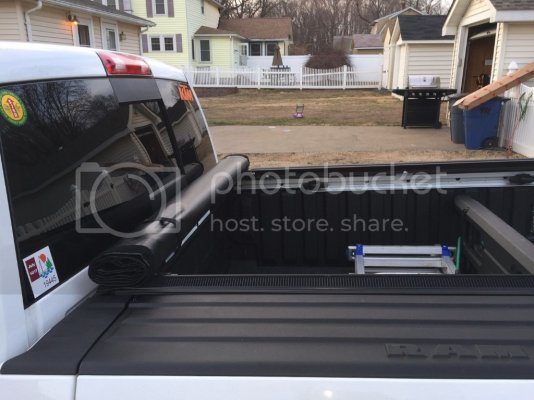

I was tired of dealing with the ram cover so I sold it and got a truxedo lo pro roll up cover.

Jack mount looks awesome! I need that

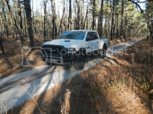

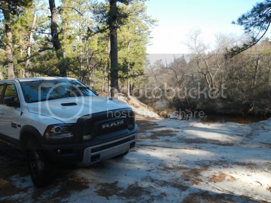

I got her off road last weekend in Wharton State Park in NJ and found out she doesn't like any thing more than rumble in a road since the suspension isn't set up to handle any whoops. I broke the passenger side view mirror from branch hitting it when it was 25 degrees out so the plastic was a little brittle.
1-1/2-2' whoops on the one road.

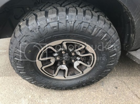

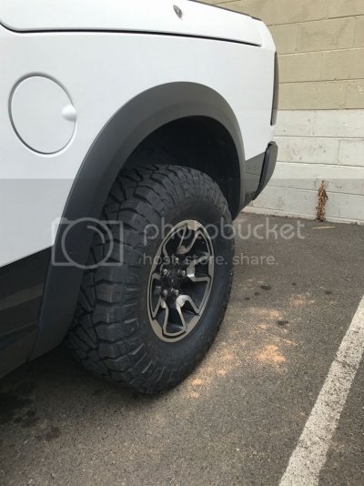

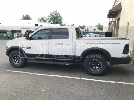

I upgraded from the 285/70 Toyo AT2 to the 305/70 Nitto Ridge grappler tires. The bigger size looks much better than the smalled stock tires.
