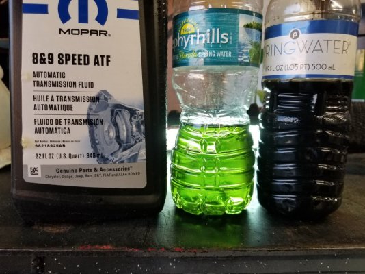

IIRC, when I rechecked mine, it took another 1/2 quart or so. About 5-1/2 qts. to fill it (with an OE pan/filter).
When I initially drained it I only got about 4-1/2 qts. out.
Old vs. new fluid
