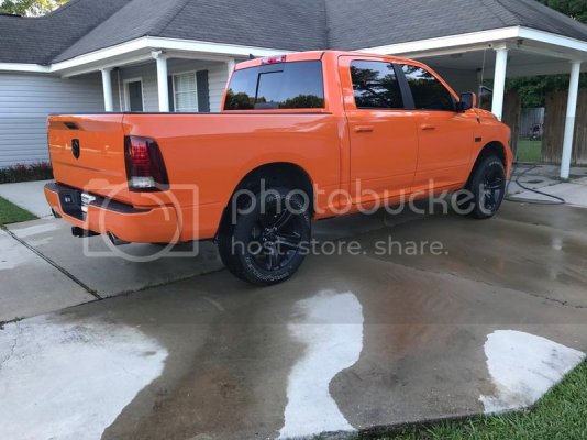

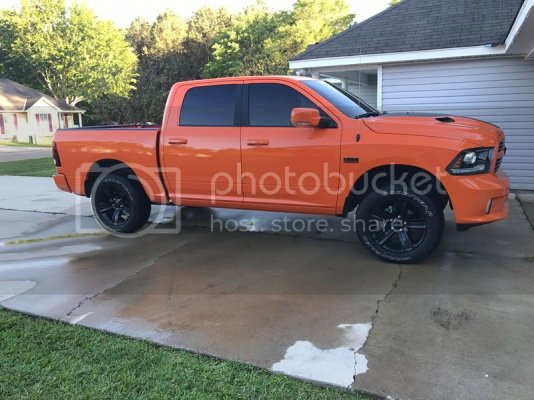

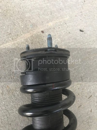

Hey Guys,
Well ended up going with the Rough Country 2.5" Preload spacer kit to level my truck. Install went great even tho I hate messing with Strut Coil Compressors. My only complaint would be getting the top nut off the strut if you didn't have the proper tools lol. This was 1 of those times I'm glad I bought my Craftsmen Max Access Thru head Ratchet set so that I could put that on the nut, And the Smaller socket on a 1/4" drive Ratchet to prevent the strut rod from spinning. Other than the Rough Country Instructions having a lot of the wrong socket sizes listed, It wasn't bad! The ride is a little stiffer which I like so it turned out well for me. I installed the Rear 1" spacers as well but ended up taking them off as it looked nose heavy again. That was a waste of an hour lol!

Are the pics you posted with or without the rear spacers in? Truck looks good bro.

very nice. are those pics before or after alignment? and 34" tires will look great with your setup
The pics are without the Rear spacers in. I believe I took some pics with them in, I'll post them for you!
These were taken after the alignment. It def needed it as it had a good bit of positive camber after! Yea I was debating doing 34's!
