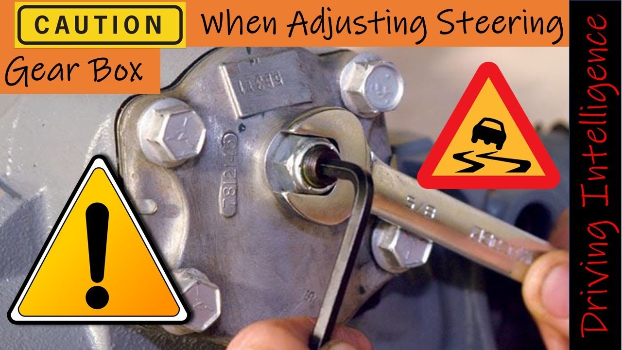

First make sure the play is actually in the box and not the steering shaft that joins the box to the steering wheel. Ram oem shafts have rubber joints that wear out. Also, the box has an adjustment nut that will take a lot of play out of the box itself. Loosen the lock nut, hold it with a wrench, use an allen key to tighten the inner bolt 1/8 turn at a time. Do not over tighten the centre bolt or your steering wheel won't self center properly. If you need a shaft or steering box check out Borgersson. It is what I use ezclusively. Not cheap but top notch gear.
