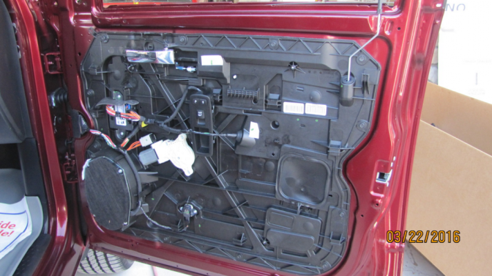

on your rear doors, there are 2 panels
one you can see as soon as you open the door
in the image the first panel is removed
it look like if you remove the speaker , you may be able to see inside
but first check the rubber inspection cover, it is maybe 5 X 5
