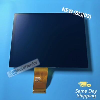

You can get the earlier model which has the delamination issues LA084X01 SL01 OR SL02 here for cheaper...
Or the newer version model LA084X01 SL03 which is supposed to be free of delamination issues but it's more costly...
