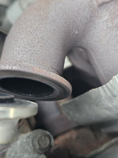

I've been slowly trying to iron out issues with this truck and my last remaining issue is a coolant leak. Its coming from the overflow for sure.
EGR is dry, no signs of moisture in it at all. I did a combustion gas test with the liquid indicator it came back negative, but I'm going to get some new fluid and try it again tomorrow or maybe this weekend when I have time.

EGR was my thought after the bottle replacement but my EGR looks dry. It could be the HG but as I said before I have a shop pull the head i want to explore other options.
