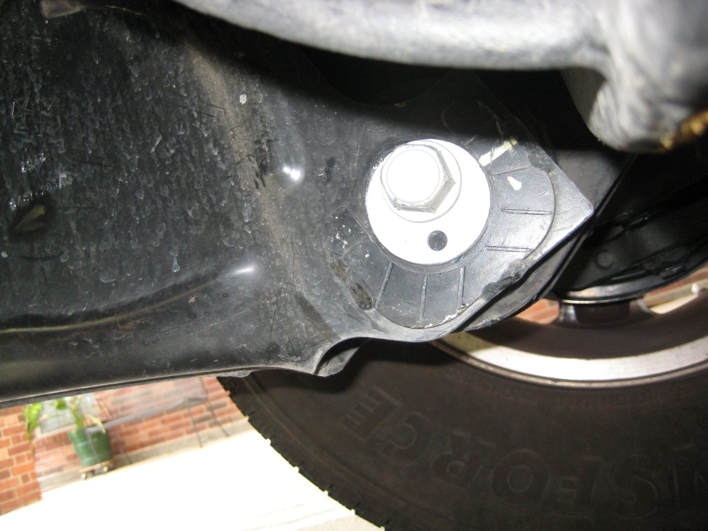

The cam in reference is the bolt just under the shock in the picturef0e385a0215927c97f1b5b2389b5885e.jpg

That is the Front. The indicator is on the other side of the bolt. Use the Thuren suspension site information for spec.

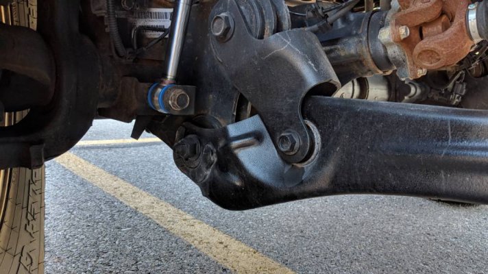

Photos of L/R cams. They seem to be set identical.
I checked tightness of both CAM bolts and the drivers side easily moved by hand force. The other was tight.
Did a crude caster angle check with an electronic protractor but can't believe the readings of 6 degrees, even though they were the same both sides. Placed the protractor on a machined surface where the lower ball joint is bolted.
Checked toe in with a tape measure across the tire treads, front vs. back and it came out to 1/4 inch. Even using a string across the tire sidewalls showed almost the same. Adjusted the toe to near zero measuring with the tape. Drove the truck on a nearby freeway and it seemed fine, did not pull but the steering was a bit off center.
Spoke with the service manager at my dealer about the leaning and he said they do not measure body or fender panels to ground, only frame points to ground or to another frame point. So the leaning I see fender well to ground is not related to a frame problem. So basically it is what it is.....
For a test, I cranked the drivers side CAM fully CCW moving the caster to near zero degrees. This did affect the height, fender well to ground but not enough to achieve level. Moved it back to the original location when done and tightened the bolt.
I'm taking my RV this weekend for a short trip. All I can do is watch everything and report back if something changes again. The real axle work will begin after Labor day.
I'll try to answer any questions if you post them.

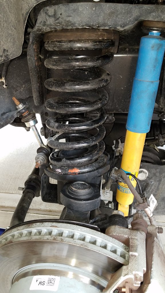

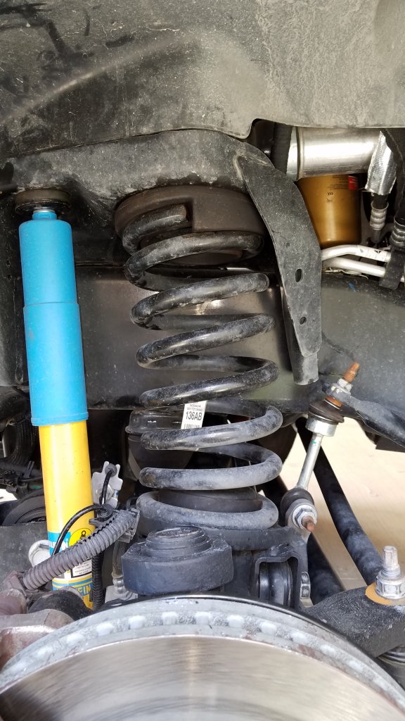

See attached photos of front springs. Took these while rotating tires.
I'm going to adjust the CAM's to get the body level left to right. I will then attempt to measure the caster angle again with my electronic protractor from the ball joint mount flange. I will post results later.
