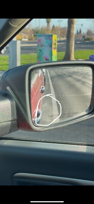

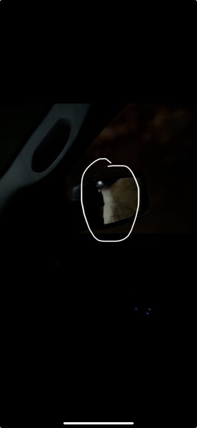

Hello all,
New to the site and been researching and trying to look up what my issue could be.
I have a 2018 Ram 1500 4wd 3.6 Pentastar with 80k.
I know with it being cold out there’s bound to be some condensation in the air on start up and initial drive. But this has got me worried a bit and trying to narrow down possible issues. When I start up at night and about 40° out, and 50° daytime, there is no initial smoke coming out. As soon as I drive away it poofs out something fierce for a solid 2-3 minutes and goes away. Then after only at idle does it come back, but normally a heavy whispy smoke. Should also point out that I’ve seen a drop of 1 MPG, but that also could be winter conditions. Doesn’t seem to have a certain smell and has a white tint to it. I’ve performed an oil change and did a combustion leak test and am seeing no coolant issue or leaks. Operating temps are normal. So my next stop is replacing spark plugs and pcv valve. Any thoughts or inputs are appreciated.

This seems like normal, cool/cold weather operation to me. It's normal for a hot exhaust to generate condensation on the inside of the exhaust while the pipes and cats cool down. On the next startup you may not see anything coming from the exhaust until it starts to warm up and even after it warms up it can take quite some time for all of the condensation to burn off and evaporate while driving.
If you are not loosing any coolant and your oil level is being maintained throughout your normal oil change cycle then it I can be safe to assume that you are only seeing the condensation being burned off as the engine and exhaust warm up to its normal operating temperatures.
When you get a chance to operate the truck for a longer period of time I bet you will see the exhaust clear up. The short drives do not get the exhaust very hot. Put this thing through its paces and get out on the big road and get the exhaust hit and it will burn off the condensation that is lingering in the bottom of the muffler and the tailpipe.

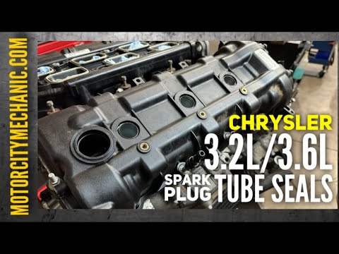

Op, I don't have a penstar in my Ram but have a hemi. My truck started smoking on cold start after sitting for several hours and I went through about a week of h.e.l.l. before I found the issue.
I did everything you mentioned, leak down test, head gasket test. Replace pcv valve, plugs and at this point it is where I found my issue.
Upon removing the most difficult to reach plug, found it was covered in oil.
Turns out, it was the plug tube gasket on the valve cover allowing oil to leak into the plug tube.
I never had low oil on dipstick, never had an oil leak and would never have thought about a plug valve cover tube seal.
My experience, never had a penstar apart but look at this video.

I had a similiar issue after we did my cam,but it leaked oil into the plug tube,nothing a new set of valve cover and plug tube O-rings didn't fix. I think any time you pull the valve covers if they've been on for awhile,you should probably replace the valve cover O-rings at the same time.

Does the smoke linger behind your vehicle or quickly disappear after exiting your vehicle? The former is oil, the latter is coolant (since you appear to have ruled out normal condensation upon initial running).
