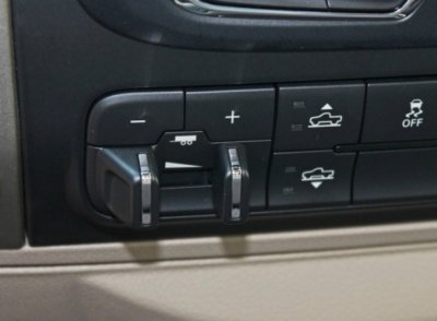

I can access the tow menu through the steering wheel now, but I have no way to manually activate the trailer brake that I see. Am I missing something still?
Look in the center dash area below the radio for a slide lever that looks like this:
That the manual lever for the trailer brakes and the two buttons above are to set the gain(brake force). Read the owner's manual on how to adjust the trailer brakes as the controller uses vehicle speed in part to determine how much it applies the trailer brakes

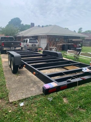

I'll go with factory then soon. Trailer I'm pulling is a 28' camper trailer frame (counting tongue) I converted to utility trailer and pretty much will remain a flat bed for a while. Although I doubt trailer itself weighs over 3000 lbs., still want to use braking system.
