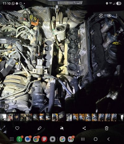

I have a 2018 ram EcoDiesel 3.0 Laramie . I drive the hell outta mine , my foot stays in it. The only issue I've had in the last 5 years is the intake and black suit build up. I regularly have the oil changed, my opinion is key to any motor lasting, the EGR Tube I belive is what its called you need to have cleaned around 75 to 100k miles. In the intake it gets caked up from the regeneration, or recycling of smoot and over time the sprayers that spray the def get clogged up. Anyway im right at 140k miles now. I went ahead and bought a new manifold for a couple hundred bucks with new swirl valves . Anyways my point is the dealership told me I needed a new motor also, that was ********. The swirl valves have these little plastic flaps in it that an actuator on the manifold opens and closes well onside was clogged up completely. Now im no mechanic im a contractor , it was a pain in the ass because all of the electronics on it there's what seemed like 100 clips you have to undo to remove all the plugs to different sensors and what not but after replacing the manifold, map sensor and one other sensor I can't think of the name right off, my truck is back on the road and wow what a difference in power after all that gunk is gone outta there . It can breath again. Like others have said you need to explain exactly what all happend up to the point of taking it to a mechanic.
One piece of advice to anyone that doesn't have one, buy you a bidirectional scanner that can read codes , that can program the ecu and that runs a million test, and you can figure out whats wrong with it exactly yourself. That's what I did. I bought the autell **** pro 808s and 901 tmp I belive is what it is, that thing is awesome. You'll have to remove the security bypass to plug in the OBD into thats behind the radio for it to read it the codes because RAM makes it to where you can't get any info from the standard port under the dash at the base of the steering column, ( money raquet) so you'll have to bring it to them.
Don't know if you got it fixed or what but wanted to put this out there for anyone that may have these issues. like I said mine is the 2018 1500 3.0 Laramie and its a fckn beast of a truck. Get a pedal commander and put in it if its not fast enough for you. Night and day the response time. Good luck
