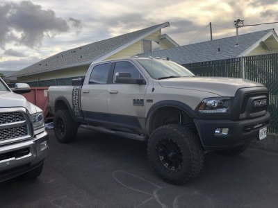

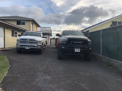

Here you go, one dirty, big, mean ass truck!
The guy in the bottom picture is my height, 5' 10"
The truck on the left is my old 2016 diesel 2500 4x4 with stock tires.
The driveway slopes to the right, the Power Wagon is actually a little bit taller than it looks in the picture with 2 trucks.

How cow. Do you have to get a running start to jump in? Haha. Yes 37” tires is almost not enough for the lift.
Looks like a super charger is in your future.
Play around with the the shift point manually on the steering wheel to to confirm the transmission is downshifting properly.

Damn, that's a great looking truck!!!
Thanks! I like it. Just gotta find more trails to go down! Kind of hard here, everything is Agriculture or sacred land. Gotta keep the peace!
I do work on a ranch though and get to take it some cool places there. I think I drive the only muddy/dirty 4x4 on the island.......
