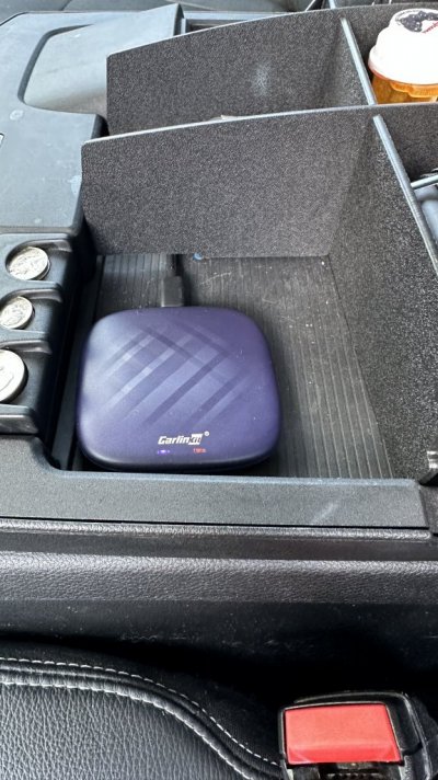

I had similar issues with my current iPhone in the past. Using the Apple branded cable resolved the issue for me. Now using a Carlinkit AI Android Auto wirelessly link to CarPlay with the same iPhone and wirelessly charge. Next is to change the USB port to power off when car is off as I have to pull the cable with each shutdown to disable the always on USB.

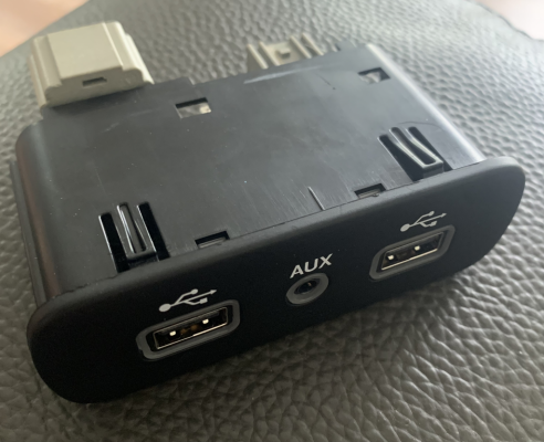

Good morning, I'm hoping someone experienced can let me know if I'm on the right track with my Media Hub problems with 2019 Ram 1500 classic. Media hub #68328704AC. It doesn't charge or connect to CarPlay, also no blue light around the usb port itself. Mopar lists the new part online at $200. My local dealership wants $280 for the part and said it needs to be programmed.
Questions:
1) What sort of "programming" needs to be done?
2) Is the relevant fuse F104 (20 amp yellow) "power outlets-instrument panel/centre console"
3) Should I be tracing wiring further back than the hub and checking for continuity? Any wiring diagrams?
Trouble shooting I've done:
-new cords, software updates etc.
-cut an old usb cord, stripped the wires, and tried to test for voltage coming through the media hub but got nothing
-pulled media hub out, seems to only have continuity across the board through the ground pin, nothing through the Vcc or data pins.
You need to check for the +12V going to that hub, that provides power to port for charging not the mini-usb that feeds the hub.
Mpgrimm2
Supporting Vendor Navy Badge
Mar 30, 2014
6,569
5,155
SC
2022 Ram 1500 (5th Gen)
5.7L
If you look closely at the back of the truck side 8 pin hub connector, you will see numbers in the plastic to identify the pins. Pins 1 (red 12v+) and 4 (blk Gnd) are where you need to check for 12v coming from the fuse (F67 if I recall correctly). If you have 12v and nothing powers up from the hub when plugged in, then it's the hub.
No programming should be needed, for a hub replacement.

To pile on. Check the connections under the driver seat too. In my truck with a jump seat, the harness for the hub connection is under the driver's seat nearest the console.
