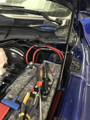

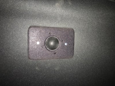

I thought I would include some pictures and explanation of what I did to replace the Factory Alpine system in a 2018 Ram. Here are the components I used:
Dash Speakers JL C2-350X
Front Doors ScanSpeak 16W/4434G00
Rear Doors Dayton RS-150P
Headliner Tweeters Dayton RST28F
Sub Pioneer 10" (Dual Voice Coil)
DSP Rockford Fosgate DSR-1
Sub Amp JL JX500/1D
Speaker Amp JL XD600/6V2
The Rear door and Headliner Tweeter are running off a self designed passive crossover. My opinion is probably biased, but the system sounds incredible. The DSR-1, while a little bit of a pain to get setup and I had to add 500 ohm resistors to get it to power up, is very powerful tool. Probably has more adjust-ability then most people would need. The pictures of the amps isn't the greatest, I still need to get things organized. IMG_3157.jpg IMG_3155.jpg

1). The factory door speakers do not have tweeters. I put ScanSpeak 6 1/2” in the front doors. These are mid-bass. The rear doors are Dayton, the tweeters in the headliner are where the factory speakers were at. I used a passive crossover here.
2). The wood covers the crossovers and this is where I mounted the amps and DSR-1. This is on the drivers side. I installed the Pioneer Sub in the factory enclosure.
3). The center speaker is non-functional now.
