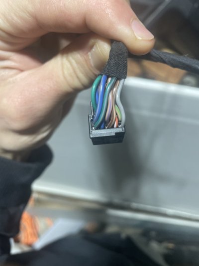

Having trouble finding pin locations for these connectors. I have found other posts but none of my colors match up
I am trying to install these mirrors on my 2017 ram 2500, I don’t care about all the options but I’d like my power folding etc to work

Going by wire color isn’t a great idea anyways, since aftermarket mirrors never use the same colors. Find the pinout for it and go off wire location, then verify with a multimeter.
What exactly are you trying to do? If your truck doesn’t have power folding mirrors and you want to add them, that’s a matter of enabling them in the bcm and added the switch, no wiring involved.

You plug that into your door module, use Alfa ODB to activate .
If that plug dosent fit your door module, you got the wrong ones.

Thanks, as I stated I am looking for the pin configuration for these OEM 2019-2022 ram 2500 tow mirrors so I can re-configure the pins to work on my 2017
So yes I need the pin out, which is why I am asking if anybody is familiar and could point me in the right direction or just post it here as I can’t find anything online.
Or can Alfa OBD switch which circuits get power so I could switch things via the computer vs physically?
Sorry if my original post is confusing

Does anyone know - are you able to re-pin a 2017 tow mirror to a 2019 (5th GEN) to simply get two functions - electric movement and heat?
Hey man did you ever figure out how to do it I’m in the Sam situation I got some power folding and turn signals ones off an 2500 5th gen and I’m putting them on a 4th gen 1500
