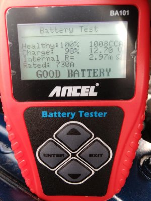

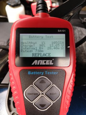

I asked them did they analyze the batteries and the guy said it it's normal. I asked then why does drivers battery have 28 ohms of resistance and the passenger side was at 2 ohm? I had put the batteries on my battery tester prior to going to dealer just to see. I kept batteries connected , and each test I turned on lights for 10 sec just to get rid of any residual and tested. (pics below)
I left truck again and they said they would test bats today. ( Instructions on battery tester said to leave bat in and test which I followed. But is it accurate when two batteries are connected?).
