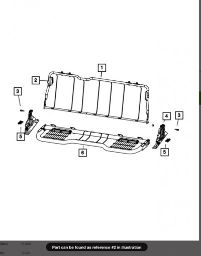

The assumption is they are...based on this:
Thanks for the pics. if any error is cuts Makes for a cheap mistake lol
And this photo...but I will look on my seat tomorrow and try to figure out how they are fastened...

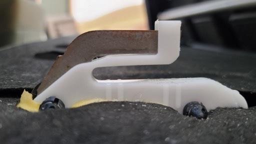

On my 2020 Classic Tradesman Quad cab I tried the washers... did not raise it high enough.
Took them out and tried trimming the seat hooks as shown by others. That didn’t work either.
Only by putting the washers in with the hooks trimmed am I able to get it to flip down.
Next time I order parts I might order a couple extra seat hooks and play with the trim links and bevel cuts to get it dialed in just right.
If that works smoothly and reliably then I’ll buy longer bolts to complete the job and have plenty of thread in those holes, but I believe even with the washer mod it’s fine.
Same boat, 2019 classic quad, lifted seat with 3/4" washers AND cut the hook flush to the beginning of the plastic clip. Still wont unlatch. Don't think the bolts will let me go much more.

In my unprofessional and often f'd up logic, the safety concern is not a factor. At first I was concerned about it, but then I realized that in both "normal" positions is that the hoop to hook location on the back wall is at the exact same place as a non-modded seat. Where I have concern is that the guys that use spacers to raise the whole seat. The hoop/hook location is now further down the opening and in a weaker spot. The hook metal is pretty sturdy though and don't even think that is concern.
I'm all for modding your truck to how one see's fit, but I'm with you 100% on the seat mod if you choose to raise the back seat with spacers. Not only are you taking the hook/hoop orientation out of normal design position, you are moving the rear seat and occupants to a different position from where the side airbags were designed.
I'm really not sure how you could screw this up. I'm the king of screwing something up... For those who have trimmed the seat back hooks and it didn't work, you either didn't take enough off or maybe you aren't pulling on the seatback at the right point when you lift the seat bottom? Again, you just have to cut the tips of the hooks off flush with where the white nylon starts. Maybe 1/2" inch has to come off.

I'm really not sure if you could screw this up. I'm the king of screwing something up... For those who have trimmed the seat back hooks and it didn't work, you either didn't take enough off or you aren't pulling on the seatback at the right point when you lift the seat bottom. Again, you just have to cut the tips of the hooks off flush with where the white nylon starts. Maybe 1/2" inch has to come off.
I took off plenty like I said upto where the plastic starts as many others have done. Quite aware off the point where it should release. Even with spacers it doesn't fold unless i loosen the bolts so back goes a little higher. Several other threads makes it look as though Ram is onto this mod as its newer trucks that have trouble getting this to work. Hell I was looking at another thread about sub boxes and guys are using 1 1/2" lift blocks to fit speakers under there now that I can see as being a potential issue

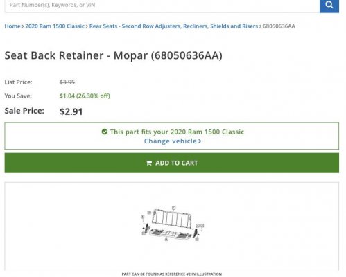

its the classic, sorry if I was getting pissy. I only tried the driver side so maybe the otherside is different? I also just found PN for the metal hook part and they are only 4 bucks so might get a couple and see if I can come up with something. Might be as simple as new mounting holes to lift them up and not need to mess with the seat mounts

My back seat on the 2020 Tradesman Quad is 1-pc...hooks on the far right and left seatback only.
I progressively trimmed hooks and installed washers to get it just right; 8 washers in front, 10 rear. Trimmed hooks flush with the white plastic...ended up a bit into the plastic to get it working consistently.
When I got it just about right there was a little bit of resistance in re-engaging the hooks; solved by beveling the edge of the cut hooks.
Then I went back and replaced the seat anchor bolts with longer ones to compensate for fewer threads into the floor.
I can raise my seat just past 50 degrees and flip the back down now which is what I wanted.

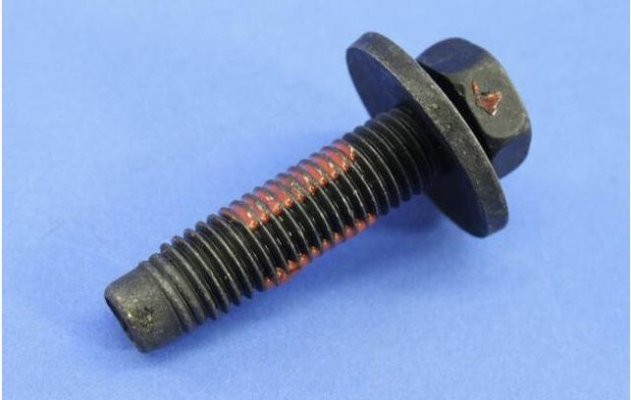

Do you remember what the bolt size is? At least the threads
I think the original bolts (altho’ the parts diagram shows them as screws, go figure) are M12x1.75x50.50(mm).
So i would go with at least a 70-75mm long bolt instead of the 50.5mm one... I raised the front 3/4 of an inch and it comes out to approximately 19 mm... The back a bit more.
Original bolt:
