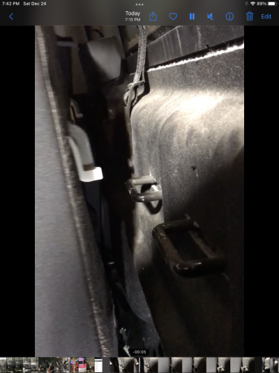

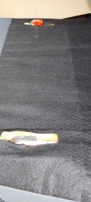

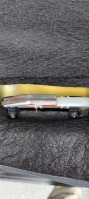

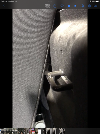

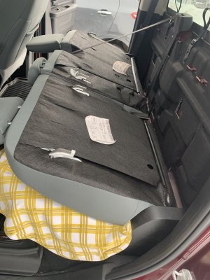

On my 17 I just cut the metal to the plastic
On my 19 classic I had to cut off a bit more to get them to clear the hooks on the back wall. I filed the inside cut to a taper but still have to give it a yank to clear so could of cut a smidge more!
Pics of my 19 classic

I like the idea of cutting the plastic only, in case I screw up I can buy new clips lol Thanks for the info
In the bottom pic you can see the pushpins used to hold em in
