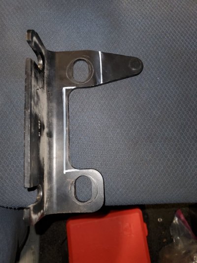

Hey , looks great on 35s!,
I think I have pictures I took, I always thought doing the body lift I wouldn't be able to use the tow hooks. After I got done with my install I tried to re install them and the hooks still lined up through the front holes, I took my original hardware slotted out the bottom holes and cut the extra off so they bolted through the new lower bumper bracket. I'll post pictures of the brackets before I cut them, I haven't re installed yet because I had to paint them.

Hey j-b for some reason I can't send a pm with a picture, basically here is how I cut my bracket kept notching it down until it fit then re used hardware with blue loctite, I dry fit everything first it may be different on yours, hope this helps!
Thanks so much! I'm gonna try that here in a couple of weeks.
