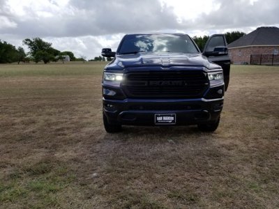

Here are a few more pictures. The wheels are a +10mm offset so they sit pretty even with the truck. I'm not a fan of having them stick way past the fenders. I plan on taking the center caps off and painting all the tiny silver screws black. I know some people aren't a fan of the blacked out look but I love it.
Leveling kit will be on this weekend. At some point I'll put some side steps and a Bakflip cover on it and maybe some fender flares.

Just got done installing the Readylift leveling kit with upper control arms. The extra money for the control arms is definitely worth it as the angle changes a lot. Was fairly easy to install though. Did it in under 3 hours. I still have to get the alignment done.
Unfortunately I realized my wipers aren't working and we are supposed to get rain all week long so I'm at the dealership now to get it taken care of. Sucks to have to park it right after I get it looking how I like.
Here are a few quick pics. I'll take some better ones after I get it back and get it cleaned up.
