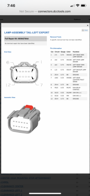

image.jpg Anyone have the wiring diagram for a 2019 PW tail light connector? I need to tap the brake light and reverse white light. Thanks.

Why not use the trailer wiring harness? A lot less of a guessing game, and you can get a t harness so you’re not tapping into anything.
