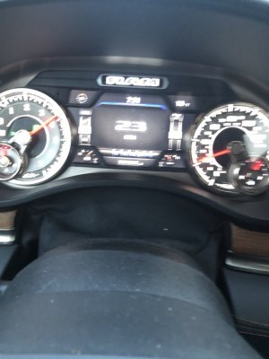

I own a 2019 ram 1500 longhorn with ecotorq hemi and my transmision like to go into manual mode all own its own has being doing this since less than 5000 miles. Two dealerships have tried to get it to act up to no avail, been at current dealer for 3 1/2 weeks can't get it to act up. FCA can't do anything unless it acts up I have over 100 pictures of this issue. What do we need to do to fix it. No I'm not contacting the manual shift paddles I drive for rideshare and my hands are no where near paddles. Please help
