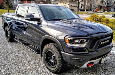

Assuming this is a 5th Gen/DT truck we are talking about, RAM downsized the stock tire from a 33 to a 32" dia.
I am running the Blizzak DM-V2s that I had on my 4th Gen at 33" tall on my '20 with no issues.
I ran 35x11.50 on my 4th Gen at stock height with no rubbing, and am hoping for the same on the 5th Gen. May try 35 x 12.50 even if I need to use spacers (shouldn't take more than 10mm at most).
