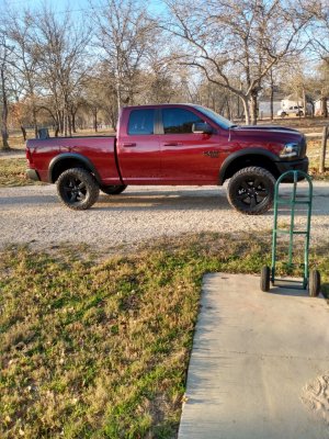

4in super lift K119b with bilstein's @ 2.1. Some of the hardware and the instructions were kinda sketchy, turned out good. The rear coils gave the correct amount of lift but are super soft. I can push down the bumper by hand and when I let go it bounces a couple times before it stops. Has anyone else experienced this? I can feel it driving and the truck really squats on take off. Not happy with it like that, any suggestions to stiffen up the rear?

Well. It looks good. Lol

Looks good! 35” ridge grapplers? Wheel spacers?
