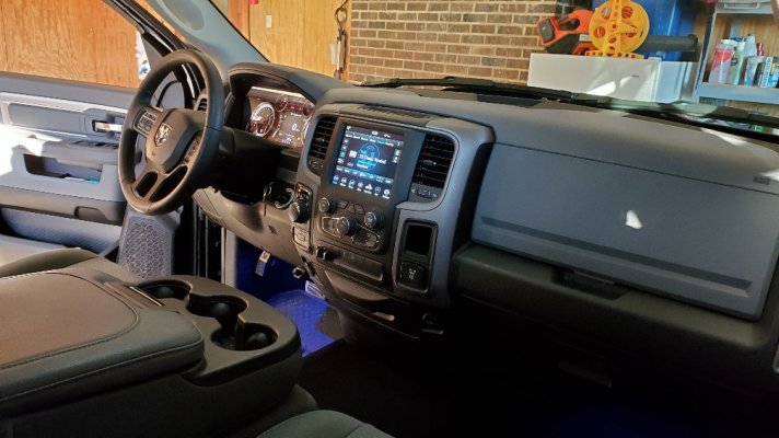

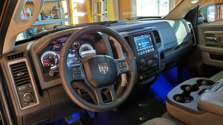

My "junkyard" upgrades with harnesses from M2mods.926be8783b0ac69884a4b936481ab567.jpg37d37f1d7379cf68b1641fb6d945b68e.jpg
