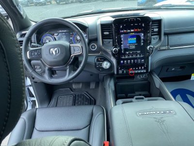

There are several ways to know if you have it or not. One of the easiest ways is to look for the switch to manually raise and lower the suspension. It would be positioned farthest left, near the trailer brake controller (if equipped).
Other ways to tell include (but are not limited to) looking at the window sticker, looking at the build sheet, or physically looking at the suspension components. There is also an indicator on the gauge cluster showing which position the suspension is in if equipped. Air suspension is standard on the Limited, but it's available as an option on all Ram 1500 models.
