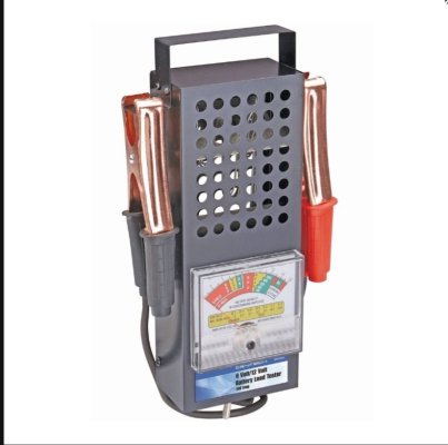

Have you load tested the battery, ideally with a toaster style load tester?
If not, that's the best place to start. A battery load tester costs about $20 from Harbour Freight.
Another option is taking the battery to a parts store and most will test it for free.
Unfortunately, most will use a digital load tester which are prone to false positives.
