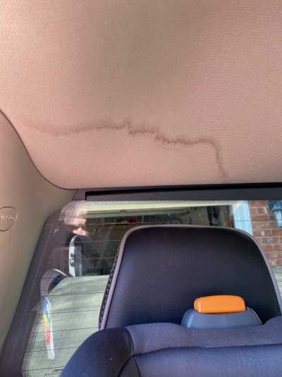

Hey everyone,
Bought a 2020 1500 Laramie Ecodiesel new from a dealer. Was cleaning my interior yesterday and looked up and saw obvious water intrusion stain on the headliner. It goes from passenger seat seen here over to driver side along the whole back. I spent all morning calling dealerships within an 1-1.5 radius of me here in Atlanta and either no one picks up or if they do, they offer me an April service appointment. My dealership said they don't have the right tech on staff right now and can't help.
How do you recommend I proceed?

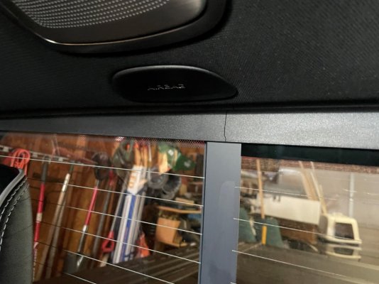

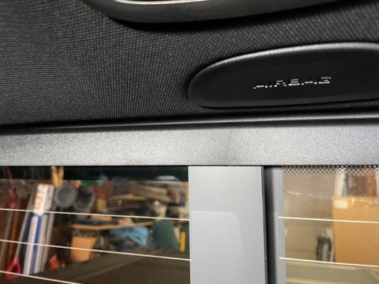

The most common area for leaks on 5th gen 1500's is the rear window frame. It's common for them to crack on the top edge, near the ends of the opening for the slider. These cracks will allow water to get inside. Lots of people have had their rear windows replaced under warranty. My daughter had hers replaced at the end of last summer. So far both my wife's truck and my truck haven't started leaking. But the wife's 2020 does have a crack on the passenger side where I described, and you can just start to see a crack forming on the driver side. We're keeping a close eye on it.

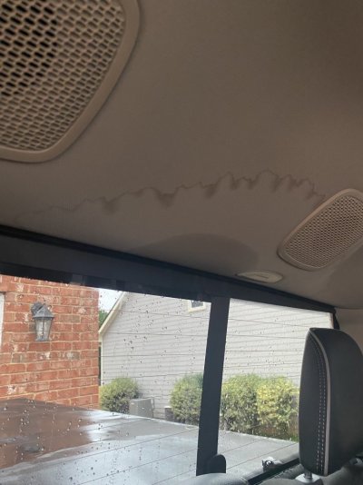

Got my truck into the local dealership, they kept it for a week and replaced the whole back window. It rained for the first time here yesterday and i went to check the truck and the leak is now worse. This is such a disaster.

wow they either didnt fix the cab brake light and or did not install the new window properly or if you have a pano roof that is the problem. they repaced my third brake light and installed my rear window in oct 2021 no leaks yet, but they did have to send back the first window ram sent it was defective. im glad my dealership knows what they are doing.
