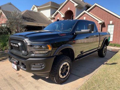

please post pics! I’ve ordered black as well and your first to get one in this colour.

I know I’ve been all over the place with the silver on rims... but it actually looks really good in the black PW. Best colour I’ve seen yet for stock wheels.

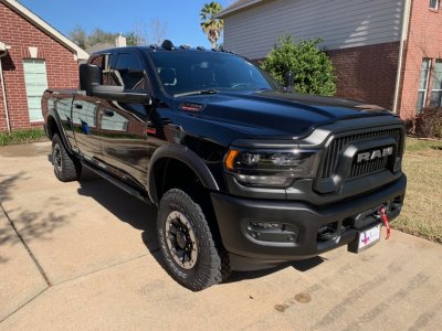

Can we get a front side angle ? Please! :)

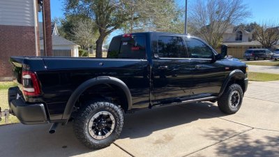

I love the retro power wagon decal on the door vs the bed decal.
I agree for me.
But I think if your going full out off road build, lift etc 37inch tires etc the in your face bed decal is awesome.
