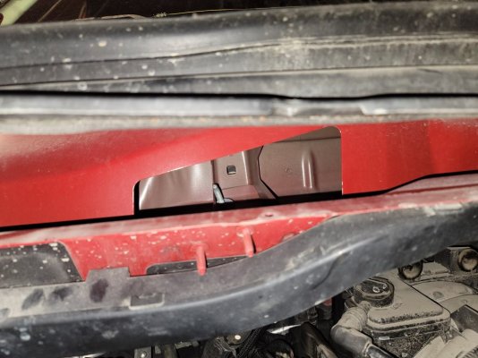

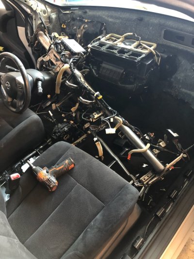

My heater core went out on my 2021 Dodge ram big horn there
are NO HIDDEN BOLTS UNDER THE STEERING WHEEL BRACKET
It's a total different setup you have to remove the dash pad includes all electric hardware on the dash itself 7mm bolts are holding the dash pad everything once you have removed the the dash pad fasteners and disconnecting electric plastic clips the black trim under wiper blades remove the black clips in fromt left up on the black trim your going to see a 10mm bolt head they're is one under the other wiper arm as well remove them and the frame will be lose i was on YouTube for hours trying to find it you can't time 4 days took my time The first picture what your truck like once your done the second picture is the dash pad and electric hardware and trim the third picture is the 10mm bolt head are located under the black trim again Happy new year thanks for reading sorry about the grammar

That about right, PIA. Had to do the same on my mother's 08 Altima.

First off Happy new year everyone
Okay thanks for reading my post
