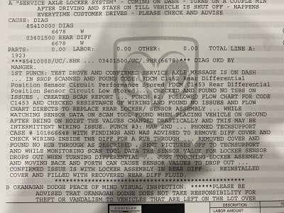

So had the dreaded "service axle locker" warning come up at 1700kms. Booked it in to the dealership, a day and a half later I get a call saying the locker assembly has to be replaced. I haven't even had the opportunity to use the lockers yet.....
Crap part is the part is on back order with no real ETA. The nice lady I dealt with said it will be at least a month before they see it. So not cool.
Anyone else need a locker replaced at such low mileage? If so, what was the actual failure?

if that was my truck im going back to the dealer and asking specific questions regarding their processes and procedures for diagnosing your supposedly failed locker.
its no secret that some dealer techs have subpar diagnosing skills and only know how to unload the parts cannon.
assembling a differential thats already been 'run in' probly isnt a task for any old run of the mill tech, not to mention if it didnt need to be taken apart in the first place.
if your doctor says you have cancer the very first thing youll ask to see the xray, scans ,lab tests and any other pertinant info to support the diagnoses.
far to many people go in a dealer with a problem and walk out the door taking the diagnosis at face value without asking any specific hard line questions.
perfect example is most any thread here about the heater not working. a dealers first instinct likely is spend 8hrs replacing a heater core that probly could of been unplugged in 30min with high pressure water

while i dont have '19+ manual, i do have '17 which may or may not be the same in the context of this subject but based on those codes the manual instructs the tech to check the harness at the front disco bar very first thing, failure to do so could result in misdiagnosis. he may have performed that step but he made no mention of it in his notes. the other strange thing is he said the values went goofy when he set the truck on the ground. makes you wonder if the FDCM final drive control module (integrated in the disco bar) or its wiring arent to blame. either way best of luck
