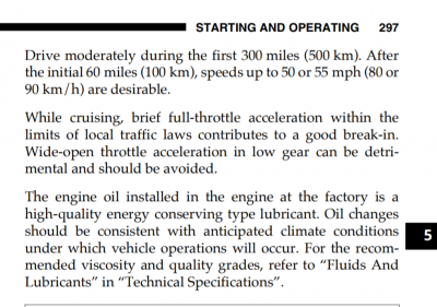

Right from the owner's manual:
Put that engine to work on e the "break in" is done or it may die of boredom..
