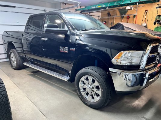

Got the suspension parts on a few weeks ago. Took about 8 hours in my garage with jack stands and a pump jack. Worse part of the whole install was I didn't have big enough sockets to swap out the front track bar so I had to find a 27mm socket at home depot. I really like the ride of the truck now. It no longer feels out of control going over train tracks and bumps at 30-40 mph. The ride is a whole lot smoother. It doesn't even look too bad with the factory 20"s and stock tires. I thought for sure I would be buying new rubber after the swap but I think I will wait till these wear out.

Here you go. I took them in the garage as it is raining out and the truck is fairly clean. :) That other tire in the first picture is my wifes Jeep Rubicon 392. Two 6.4l hemi's in the garage, does it get any better than that?
