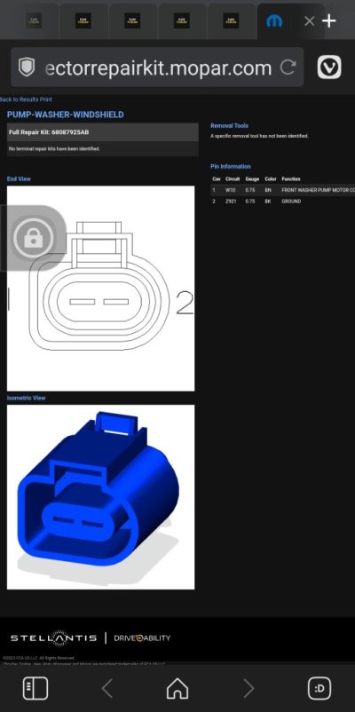

Hi guys. Does anyone have a bcm connector pin out diagram for a 2021 Ram 1500 DT? My windshield washer pump is not getting 12v. Has a good ground. Using Jscan I was able to get into the bcm and watch the settings as I pressed the washer button so apparently the bcm is getting the signal. If I command it to turn on it does not but the wipers do. I did a bcm reset with no difference. I can hear the internal relay clicking as I press the switch. I'm thinking maybe the internal non-serviceable relay soldered onto the board inside the bcm may have failed.

I have a good ground at the pump wire connector. The other lead does not deliver voltage when pressing the button. When you press the button you can hear it clicking under the dash and the wipers turn on for a few cycles but no pump voltage.

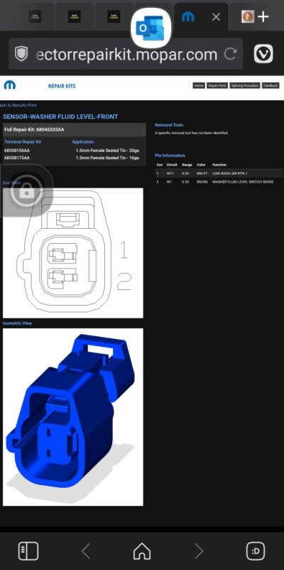

Thanks RamDiver. It took me a while to figure out how to save those not blurry. I zoomed them as far as the page allowed without cutting anything off and then hit screenshot in the browser settings and saved them. I appreciate it very much. I couldn't open the 2nd link. I was getting the dreaded 403 Forbidden error..
You're most welcome.
The second link can be a PITA sometimes.
It connects OK for me this morning but won't allow me to search properly.
I entered year & platform and was then able to scroll down to Pump-Washer-windshield.

You aren't going to believe this... I wasn't checking the wire on the pump. I pulled the connector off the low fluid sensor that's easy to get to under the hood. I had to pull the fender flares off and the lower facia off to get to the bottom grille bolts to remove the grille. I would definitely like to add something to this. Ok so I bought this 2021 Ram 1500 4x4 Rocky Ridge package brand new. it had 16 miles on and I took it for a ride and told the guy it's mine.... So I started using Rainex washer fluid in this vehicle. I had a 2012 T&C and never had a problem with it. So the nozzles got clogged and the dealer put a new set on since I was still under warranty. They never said anything about the orange stuff in the reservoir. so about 4 months later it happened again but this time I changed them and found out these forums that these vehicles don't do well with Rainex.... At the point of repair I drained the Rainex out and disconnected the hose under the hood and flushed it out real good with vinegar and blue old fashioned washer fluid. well guess what? I'm on my 4th set of nozzle's. (counting the original ones) This time I didn't pull down the hood insulation I just changed the nozzle without the hose attachment. I know why which also relates to early washer pump failure. Ok so you've probably seen threads or You Tube videos about these trucks where the washers don't work because the hose came apart under the hood or under the hood insulation.... well sure that's a quick fix but why did it happen?? The trucks that have the washer nozzles mounted under the hood, those nozzles are way too restrictive. I was hoping to buy aftermarket nozzel's but no luck Amazon says yea and sends me the ones that mount on top of the hood. I can blow right through those but the brand new Mopar ones for my truck I can't blow through them. They are way too restrictive which IMO causes the hoses to blow off, clogging and early pump failure.... Appreciate the help and also to others trying to diagnose the washer pump. The wire connector that you can get to easily under the hood is for the low coolant warning sensor.... I had to pull the grille....
The second link I listed above is often helpful for identifying connectors, when it functions properly.
When the search feature goes wonky, you can usually select the platform and scroll through the results, line by line.
If using a PC, use control F to word search the listing.
It will then provide a picture of the connector and wire colours.
