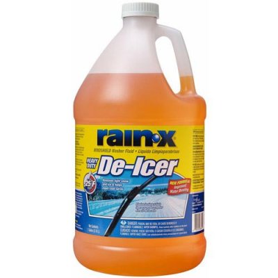

I used RainX several years back even when the jug didn't have a level sensor and it left a film of this gilactmus gunk in the filler bottle and even took out the pump, I will never use it again.
