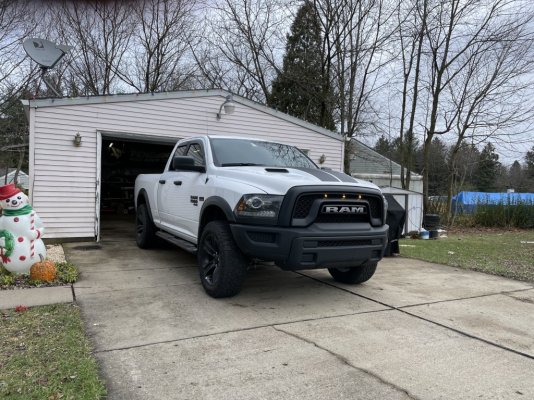

Just trying to decide on a good leveling kit for the truck. I had a 4x2 2010 Ram before this and don’t know too much about the 2021z any comments would be nice. The new truck is a 4x4 2021 Ram Warlock. I saw the belstein leveling kit and am interested in it just not sure what to do.

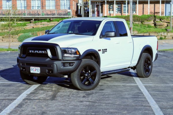

The Bilstein 5100's are a great inexpensive option. I've been running mine at 2.8 since about 500 miles from the factory. You should sit level with them at 2.8 on the warlock.
Here's mine at just 5100's at 2.8 on the front, stock everything else

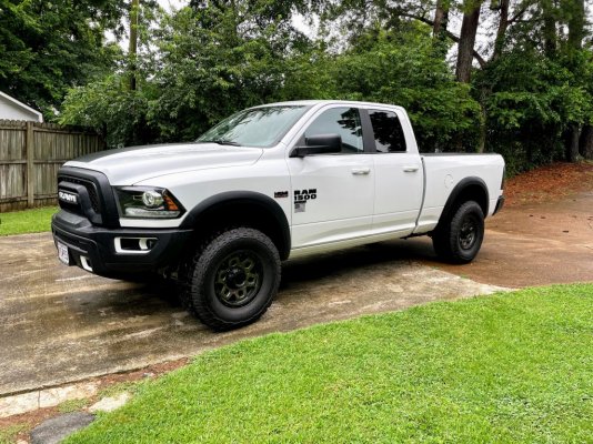

Here she is on 35's
And here is with a zone 1.5" body lift making it a 4" lift total
