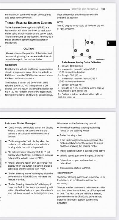

I am not finding any information on forums or web to describe how the Ram trailer back up assist works. I owned fords with this feature and when it worked, it was great. It required a sticker on the trailer and calibration. I now on on my 3rd Ram and miss this feature for tight solo backups. I am considering replacing my truck with a 21 Ram to regain this feature. I have only heard that a sticker is not required, it "sees" the trailer. Dealer did not know how. Question- does it use the 3rd brake light camera (so a canopy will block the view?) If anyone has any knowledge of it, would be appreciated.

yes, and i have called several dealers who all did not know. I think I found my answer though from a dealer in another state who says it is required, so to answer my question - you can NOT have a canopy installed with the trailer back up. Too bad.

I ended up trading my 2020 in for the 2021 yesterday to get this feature. Really nice package and it comes with sensors for the trailer tires that interface with the TPMS system. You have to calibrate it in a short drive forward and make two 90 degree turns, but cameras seems better than the Ford sticker solution.

I already have the back up camera on my trailer. It helps see where i am going. Back up assist is to help with steering direction and amount. I find it much faster.
