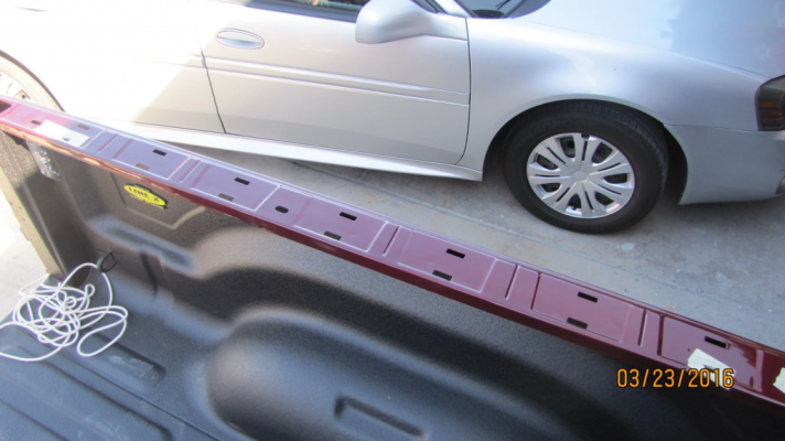

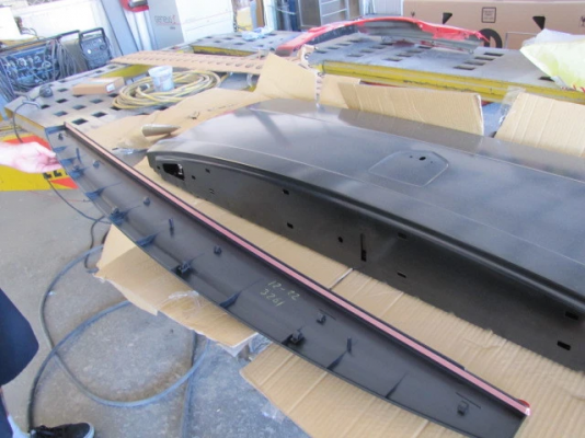

Many times, the clips break off when removing all of the plastic caps
You may be able to open the tailgate inspection cover
Use a flash light & mirror, or maybe even better,
use a Cell Phone & take pix
Then you can see how to release the clips from inside of the tailgate.
