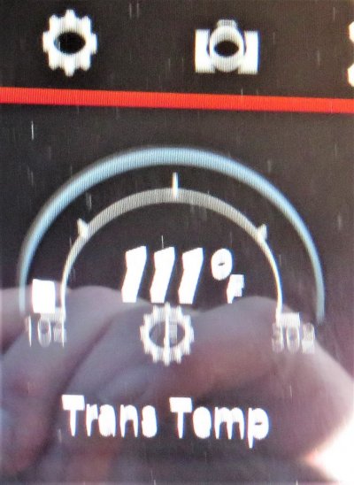

The HD 2500's don't have the transmission heater like the 1500's have,and that's about par for their operating temps from everything i've read on them.The wifes 6.4 Challenger doesn't have the heater either,and i can leave Airdrie on a cool 40F day,run at 120km's on the QE2 and it'll be almost at Red Deer before it hits 150F.Crapppy pics,but this is a run over to Drum last fall where i was only cruising at 85/90 clics on the back roads and it didn't get over 111F.I was driving it pretty easy as it pulled down over 31 mpg on the trip,so i was pretty light on the pedal

They might not have a heater per se but they still have a thermostat and bypass. Where the the fluid will bypass the trans cooler til it hits a certain temp and then the thermostat in the bypass block opens and allows the fluid to flow through the trans cooler. It usually takes my 16 a good hour now because of the colder temps of constant driving before it hits 168 which is what mine stays at once it's warmed up. In the summer 70-90 degree weather it still takes a little over a half an hour.
Alot of HD guys go with an aftermarket bypass that gets rid of the thermostat so the fluid always go through the cooler and trans temps stay cooler. I will more then likely be do it to mine come spring. Winter now and don't drive the truck on long enough trips for the trans to even warm up.
