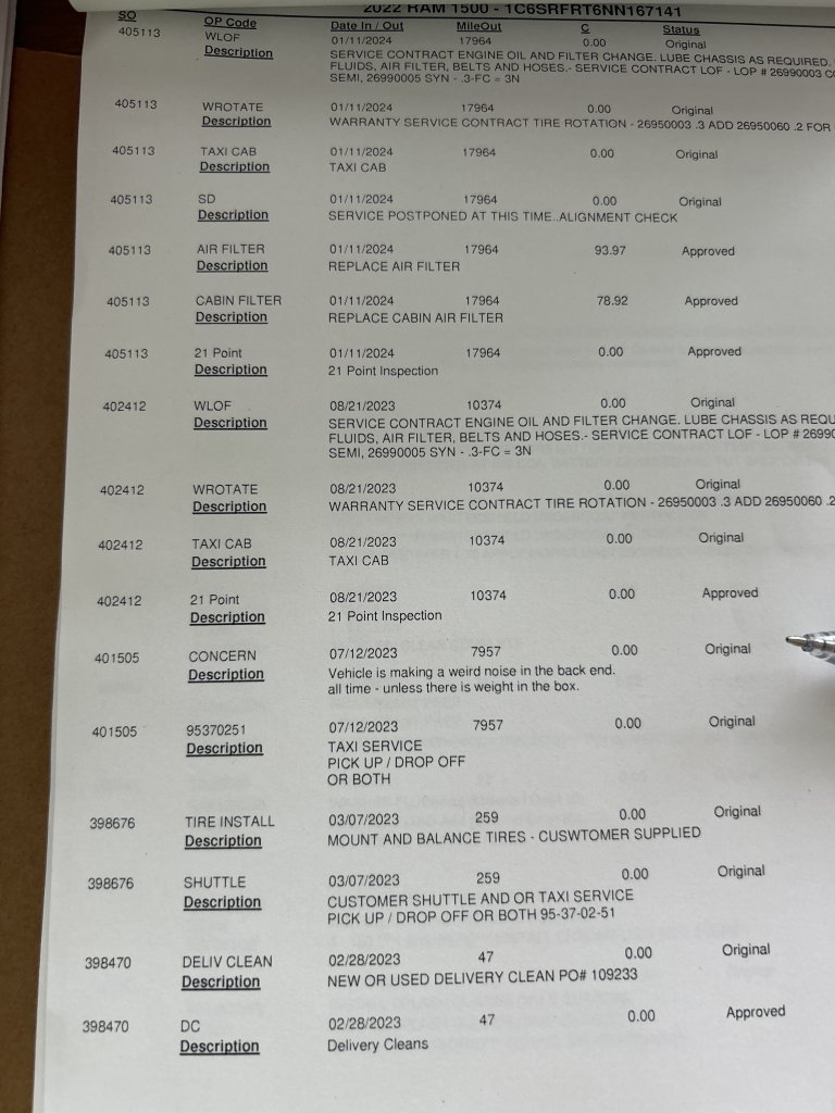

I recently found an old work order from when the truck was relatively new, and the dealer had documented a rear suspension noise. At the time, they noted that the noise wasn’t present when the truck was carrying a load, which makes sense because the suspension is under compression. However, when the truck is unloaded—as it is most of the time—the noise is very noticeable.

I also have a copy of an early service work order from when the truck had approximately 7,000 km, and it already mentions a rear suspension concern. The truck now has about 45,000 km, so I believe there may be an underlying issue that has existed since early in its life.
