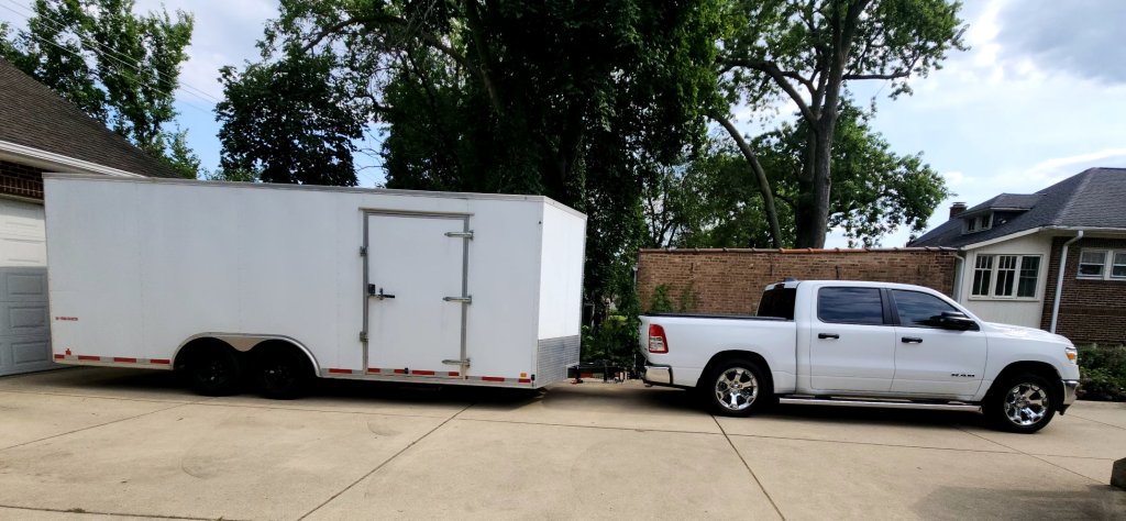

I'm attaching a few pictures of the stance when I last towed the trailer and car over this last weekend. The car trailer is sitting level but the rear end of the bed squats some. I will say that I had probably 600 lbs in the bed, and 200 lbs in the rear seat area. Do you think this is something thay needs attention? I will say it drives extremely nice with the load and loaded car trailer behind.
The best way to determine if the WDH is set up correctly is to weigh the truck/trailer on a CAT scale. You'll want to weigh the combo together fully loaded then drop the trailer and weigh just the truck. This will give you all the numbers needed to determine tongue percentage and if the WDH is adjusted correctly. On the truck you want about 10% tongue weight, the front axle weight the same as when the trailer isn't connected and the rear axle to weigh more than the front axle.
Just because the truck/ trailer is level doesn't mean it's correct.

There will be times upcoming where they'll be more overall load on/in the RAM and trailer. A for instance is this picture is less the occupants (two) but I have done this with four people and their luggage too.
Even with the soft rear ends Ram trucks have, that truck has too much tongue weight, and an improperly adjusted WDH. Even using air bags to level the truck out, if the trailer isn't loaded correctly and the WDH adjusted properly, that trailer will push that truck around.
This is an excellent video of showing the effects of air bags vs a WDH and why proper set up is important
