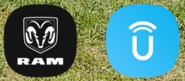

It can be VERY confusing. The system is called Uconnect and is what you're referencing. But I believe what THE OP is referring to and what I've discovered is prior to 2022 the App available was/is called Uconnect App.
Now Ram is getting away from using THAT App and wants you to use the RAM Connect.
They're 2 different apps accessing the same database, but I've found inaccuracies with the RAM Connect App and prefer the Uconnect App. The Ramconnect app you can add service records so I do use it for that.
The pic above in my other post is Uconnect App.
Below is a screen shot the RAM Connect App that they now promote you to use.
These are the 2 different icons.
