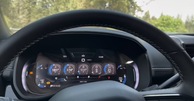

18CrewDually
Nov 17, 2019
2,421
3,414
U.S.- New Jersey
Cummins 6.7 H.O.
2025 Ram 3500 SRW Cummins with 5 tiles including transmission temp, 3rd tile from the left.
