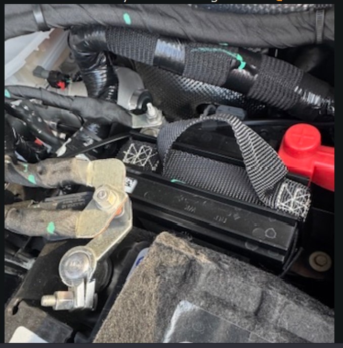

The search utility in the upper-right will find numerous threads discussing various failures in 2025 & 2026 model trucks. Both of these years share the I6 dual turbo and the newer Atlantis High electrical architecture.
The following article has identified ground faults and a 12-volt power system that is unable to regulate the voltage sufficiently with the turbo system. This lack of regulation creates problems for the computer modules, resulting in a myriad of problems.
The issues vary from minor inconveniences to sudden explosive runaway accelerations, as mentioned above by Mpgrimm2.
Key Takeaways
  • Identify structural voltage drops rather than accept simple software-glitch explanations from factory service centers.
  • Inspect and clean factory grounding blocks down to bare metal to eliminate high-resistance points.
  • Monitor dashboard behaviour during high-load scenarios, such as trailer towing or high-altitude mountain ascents.
  • Upgrade to a premium battery to provide a stronger electrical buffer against high-amperage powertrain components.
I would consider the recommendations covered in the article, especially refurbishing all of the common ground blocks, as well as adding 'The Big 3' electrical mod, and an H8 AGM battery.

Thank you. I did notice that the voltage fluctuate between 12.4 and 14.4 on occasion. Not sure if it's related to my problem. Forgot to mention that the start/stop always gives me the message "not ready, cooling or heating ".
