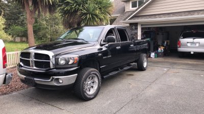

MegaHemi5811
Jun 5, 2018
6
Oregon
2006
87C649B6-28ED-44D2-8061-70E9975675E2.jpeg A71639FF-5D1F-4244-B37E-E222D50E73CF.jpeg I went from 18 on a metric 32” tire to a 20 on an 35” tire. To me the ride was noticeably different, not as smooth but not too bad but also $$$$.
