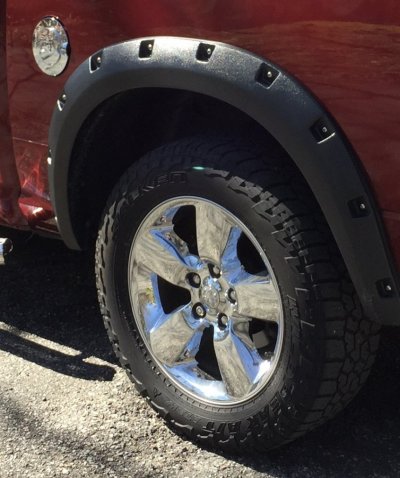

So these seem like one of the standard factory ram rims on trucks of various years. Are these really the same rim size for all and if so, what is the offset of these stock rims. 1691539687010.jpeg
ilovemyramlaremie
Mar 19, 2018
789
803
Moravia NY
20x10 -19 offset
