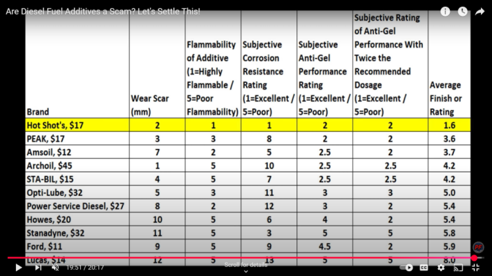

Thank you for your information. I ended up purchasing the hot shot secret diesel additive and actually purchased a combo set. One is extreme and one is everyday. As far as the oil is concerned I don't change the oil, the dealership takes care of that for me. I found out they are using a synthetic oil for my truck. I don't know what brand of oil they use, but I assume it's suitable for the motor since they are a Dodge Ram, Jeep dealership. Today I was just looking into upgrading the air intake and along the way I'm picking up more information about things like the fuel additives. I haven't put anything in the truck yet so if you have any doubts or suggestions please let me know before I go dumping that stuff in my fuel tank. If I only knew then what I know now I might have purchased a different vehicle. One that's not so temperamental about idling and short drives and and all the concerns that come with the diesel motor. Previous to the tradesman I had the 1500 Classic Hemi and drove it like any other truck I've owned until I took it in to the dealership for it's scheduled oil change and swapped it out for the Ram 2500 Diesel. Bit more expensive, but they gave me a better percentage rate than the hemi. Winner winner chicken dinner. I've never been so concerned about a vehicle as I am about this Tradesman. Hey, at least I got the cheaper downgraded model. I've had it for 2 years now I guess it's time to trade it in for that new TRX model!

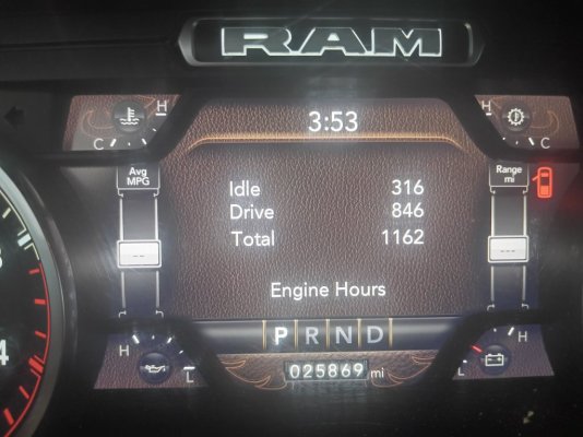

It's hard to say with new technology. Maybe things have changed since the old days. I don't think I'm killing my truck but apparently I'm not living up to 100% of required driving standards. I've owned my truck for 2 years now I haven't had one problem with it but I hear all kinds of information regarding how to keep a diesel engine in good working order. I just found out today apparently according to my idle hours I put on a additional 10,000 MI. 316 X 33. The drivetrain is warrantied for 100,000 miles so I still got 70,000 or 60,000 miles to go before I got to worry I guess.. just trying to be positive. I know I'm not the only one that has questions about diesel engines because I've read some threads and obviously there's more than one forum regarding diesel engines. I've never been so involved on retaining the information regarding maintenance on a vehicle as I haven with this truck. Every other vehicle I've owned I never bothered researching the information like I have been recently regarding my newly purchased diesel truck.

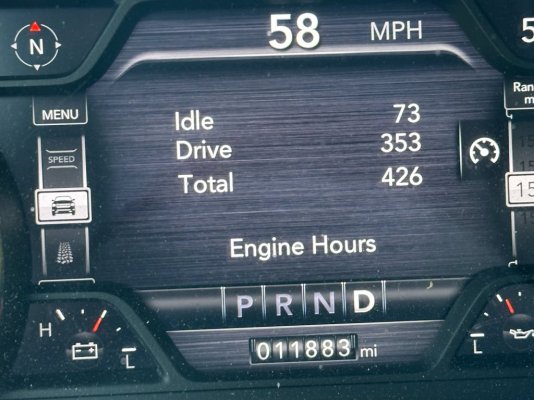

Below is a photo of my engine hours from last month.. IIRC Cummins wants to see idle hours at or below 25%

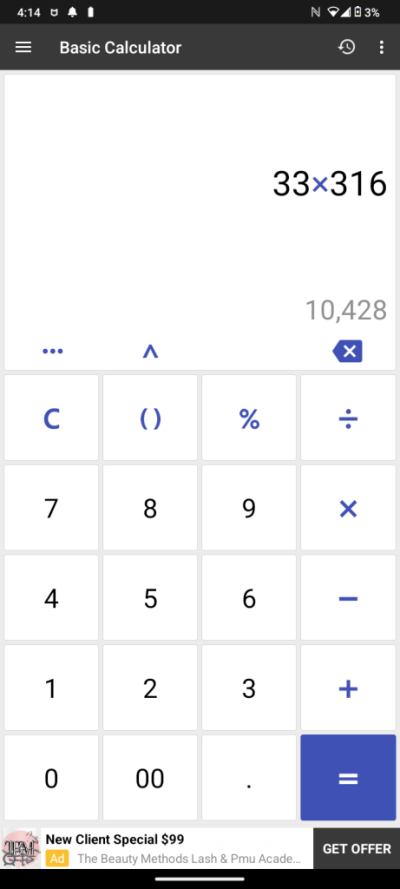

Damn you doing better than me that's for sure. I don't understand how I accumulated so many idle hours. If you do the math at 316 hours I think it was, that's 12 days in a row just idling! I just don't understand where all these hours accumulated.

So I'm guessing the answer to my percentage being so high regarding idle hours is to drive it long distance periodically once twice a week? Well that just gives me a good reason to drive to Yosemite. You're a 17.4% of your overall hours on your diesel where is I'm at 27% of My overall total hours
